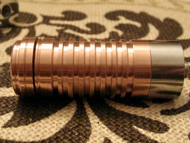

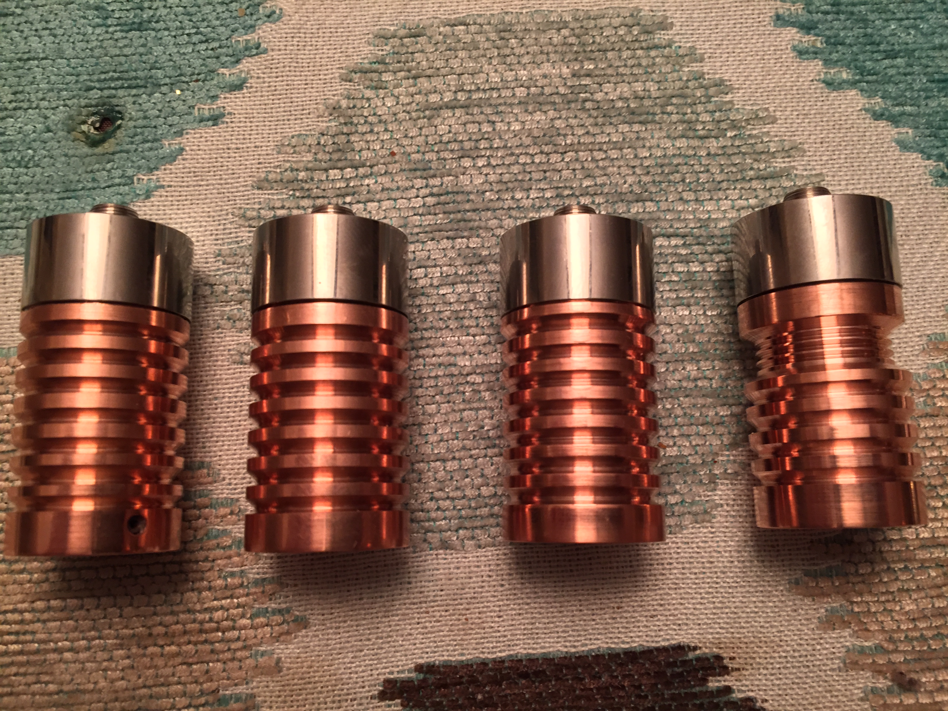

Hi,
The back threaded end of the that Icecruncher posted will not fit the DTR22mm vape module. It is much larger than the treads on DTR's modules. I machined plenty of these for LPF members in the past. Here are some pics. look through my sig.
Rich:)

Hi,
Rich:)

Hi
I purchased the back 510 adapter part and I machine my own heat sinks and I thread them to fit the 510 back halfs
My 510 back half’s won’t fit the DTR aluminum 22mm heat sink
Rich:)
