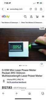

Hey everyone.
Anybody have one or know about this meter? For the price?!
I believe Jerry, Lasersbee, may have taken one of these apart and they don't have enough parts to make them accurate at all. You really do get what you pay for.
