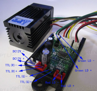

Ok I received my Aptlightingworld 200mw 532nm labby.
It peeked at 203mw quickly but stabilized fast and only does a 176mw constistent even after 5 minutes of run time.
A few issue's with this unit that could be better. Like I said stability is great but the focused spot doesn't get to tight compared to my other 532 pens. The knob/lens itself is pretty long with alot of threading and focusing it take's alot of turns either way to find the right spot. It's also a bit sloppy but I guess that issue can be fixed. The knurled knob and lens threading are one piece and the lens is pressed in from the back. The front exit hole is obviously smaller.. I don't know if trying any new lens if even possible could tighten the spot.
The driver has a tiny LED that lights green when its on which is kinda cool, not a tiny bulb but just blends in like a tiny resistor on the driver board. I don't know if there is anything under the bottom of the driver such a pot screw as its screwed down to the plastic holder. I just literally grabbed this unit from my mail box 30 minutes from this post and haven't played with it to see it's likes and dislikes.
I do have a few questions as to the proper LPMing tests.
I usually turn on what ever i'm testing first and then slide the spot over the LPM sensor head, instead of turning it on as it's aimed at the sensor.
Any advice??
If your curious of the inners.. Forgive my bad pic's as my cheapie cell phone seems to be taking even worse pic's lately plus my shakey hand.
With the fan removed the back has a added little board with a little added 750 resistor.
I see no plastic spacers between the module and heatsink body in this one..

Sep 20, 2013
17,462
For the money I'd say you did okay, Peter. Even if it settles down to 176 mW, that ain't terrible. You need a better focusing camera as your photos seem to come out poorly. I can't really see what is there. It's time now to enjoy it. Thanks for the review.

Ok, just trying to show a better pic of the front of the module. The glue holding the expanding lens is layed on a bit heavy.
The module is about 14mm wide which is a little wider than the standard 532 complete modules, which also makes the main lens a bit wider..
If anyone knows of a 14mm ish wide barrel with a lens maby I can try to tighten the spot a little bit, it's not all that bad but still wouldn't mind it a little better.
