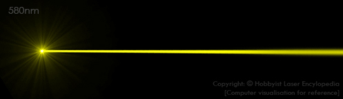

To clear up the colour difference I have included notable wavelengths across the a rough observed temp tuning range of a common 635nm diode. It should be noted that these are daytime visuals. In darker lighting conditions they will appear redshifted unless compared with a longer wavelength laser.
As you can see not too much noticeable difference between 607 and 613nm. 607nm is only noticeably more yellow with the bloom. The clearer difference is with the 622nm. It is unlikely even with the night-time redshifting you would mistake 613nm as red. You would have to view a short wavelength laser right next to it, for it to suddenly appear blood orange I would expect.

Yes, that probably is the only way of truly noticing a difference by eye. Having them side by side. For there to be a difference in colour at that part of the spectrum, you would have to shifted it at the very least 5nm. Do you reckon you could manage to get close to 625nm?

Personally I think it would be more accurate to say 613nm has more red in it than 607nm having more yellow in it. Semantics. Pictures are difficult to give it justice, on my monitor your 622nm example is closest in color to my 607nm.
