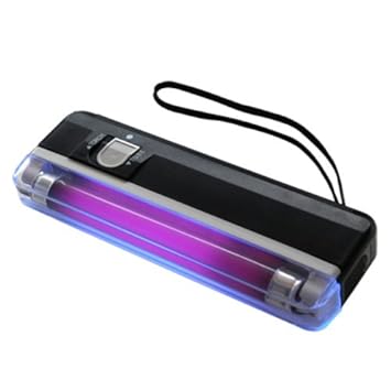

I use a flash of the 365 to harden it in an instant but then a few minutes under a normal blacklight to fully cure it. I use something similar to this.
You can cure it in a pinch with just a blacklight but it takes maybe 30 minutes and its not a very good bond. It only works if you remove the plastic cover.
