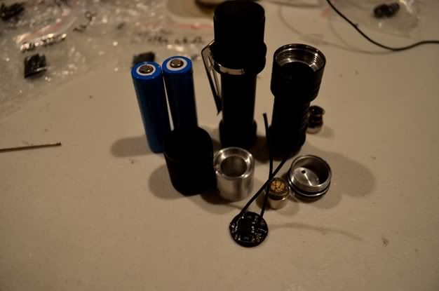

The Host - Lighthound 2xAA Tactical Flashlight
Parts - M140 445nm diode, Mohgasm 1.5A Driver, 405-G-1 lens, Jayrob
custom aluminum heatsink, 2x 14500 trustfire battieries

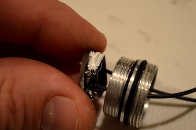

Before I mount & seal the driver in the pill, I'm going to use Ceramique 2
on the drivers' resistors AND to create a bond between the heatsink & the
pill. Why Ceramique 2 instead of Arctic Silver?? Because Ceramique doesn't
bond or completely dry, if I ever have problems with this build I can always
take it apart after cleaning up the mess
I aimed to fill it in good under there without making a mess
The first side was a little cleaner
Next I added a big gob of Ceramique to the point in the pill where the
drivers heatsink will almost press against
After pressing it all together, I noticed I had sanded down too much on the
edges of the battery contact. The contact wasn't secure in the pill, so I used
some Arctic Silver to hold it in place, then soldered a wedge between the
edge of the driver & the threading on the inside of the pill. The driver is now
secure in the pill & you can see the gap where the driver isn't touching

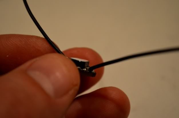

Grabbed the pre-pressed M140 for soldering
Added shrinktubing for protection
Soldered both leads
Covered the exposed areas
Turns out I didn't need the extra tubing, using that much length would mean
bending the diode pins on the face of the pill

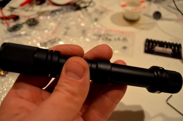

Added the top half of the host
Screwed on the bottom half, installed the focus lens and its done!
Now to see where it hits on the LPM
Because of how small this laser is with this output power, there's no doubt the entire thing gets warm after about 1 min of runtime. That's good heatsinking though, thanks for checking this out & let me know what you think!! :beer:
