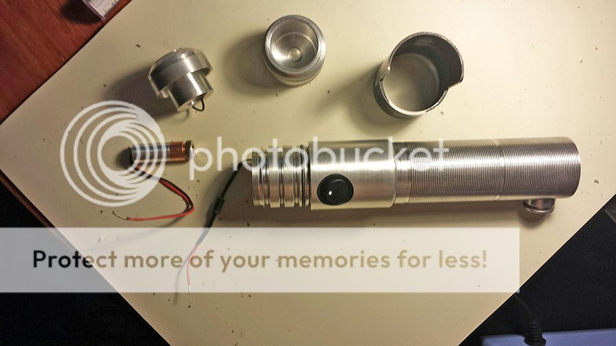

On my Lightsaber build I put one inline on the positive lead with the cathode towards the laser driver as you can see here:
The negative lead from the battery on this host is on the heatsink as you can see in the picture (a case negative build basically).
Below is a closer pic of a diode so you can see the silver cathode line more easily.
