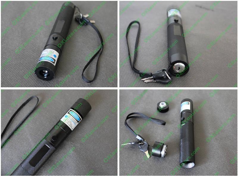

It comes in a handsome aluminum body with a rather nice looking blue
finish.

To get the laser to turn on, first be certain that the furnished 18650
cell is installed. If it isn't, then install it (see directly below),
and THEN you can activate it.
Aim the laser well-away from your face first.
Press & release the
tailcap button to turn the laser on; do the same thing to deactivate
it.

445nm 1000mw focusable burning blue laser pointer with star cap and key lock - 445nm-450nm blue laser - Blue Laser Pointer - Laser Pointers Catalog - Blue, Red, Green Laser Pointer, Powerful Lasers - OXlasers China
inTHIS PRECISE PIC http://img.diytrade.com/cdimg/925334/17631763/0/1291530922.jpg
i can see that in the 4th pic .. the front head that do STARS.... in reality "seems to be" a normal 5 in 1 head.... with an EXTERNAL BLACK adaptes...... but for reality i think it can accept EVERY 5 in 1 head.... nice!!!
i really want my first 445nm laser... my i am a strange boy.. i prefer MOMENTARY ON press button. i hate switch on and off laser...... i find that they are not so safe.. and not so easy to play with.....
this seems to be the only one 445nm boiuld with a momentary on button

.... but i see.....there are a sort of thread... where to put an optics. am i wrong?
i see it by picture..... i think that hole... allows to screw this http://www.laserlands.net/media/cat...8d6e5fb8d27136e95/5/3/532p-20-6in1-yh_3_3.jpg
Closer examination did in fact reveal a threaded female receptacle that the holographic "starfield" generator from the Dapper Stage Laser Light Show screws properly into.
