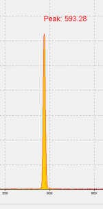

Got mine today - also confirming 593.5nm. You'll probably have better luck revising the listings for a known wavelength to search for. Feel free to use my spectro measurements below or to ask for cleaner ones as these are a bit sloppily cut
I'm pretty convinced this is the usual yvo4 process now. I'm getting 8mW of visible light out. I first rescued it from baking in my mailbox and it only did 532. After I stuck it in the freezer for a few minutes it finally spat out yellow.
The spectro jumps between 593.3 and 593.7 which at that point is at the limit of its resolution. Take the average, and... yeah. It reports the same for a known 'real' 593.5 lab and LG Rigel/CNI GLP pen. Can provide measurements of those if needed, just didn't bother to screenshot them. These are not IR filtered, so you will have a bunch of 808 and deeper IR to filter out yourselves. These leak both 532 and 671 as well. Some proof:
For some more subjective info, it likes it cold. Once you have it on for a minute or two it eventually just gives up on yellow entirely and only leaks some 532, which eventually fades to nothing at all. While it's on you'll see the brightness jump and dip wildly. Much more typical of yv04 than the SFD crystals which in my experience have been very stable. If you're in a warmer area or like it warm inside, you may have some trouble with these.
I wasn't able to take it apart to confirm if this uses a single crystal or two crystals, or what the crystal is made of with any proof. I just suspect it is yvo4 because its behavior is in line with my rigel and labby startup. The aperture is too small for my camera to peek inside, and I do not want to ruin the host, break it or even risk the chance it is something hygroscopic, so that's as far as I go.
Let me know if I missed anything.
