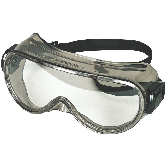

My first guess would be to heat it up and slowly melt it with a heat gun. Make sure you're outside and have goggles and gloves. Not safety glasses, GOGGLES WHICH COVER AND SEAL IN YOUR EYES. There is nothing worse than glue vapors depositing on your eyes

Not glasses, GOGGLES. I can't stress enough that you need GOGGLES NOT GLASSES because the vapors can get under glasses.
These are goggles

Ok,thanks for the clarification googles not glasses ! got it . thanks. Any idea on how high to take the heat. Without hurting the diode?

Those goggles will not form an air-tight seal around your eyes either, you'd probably need to use a full face lab (gas) maks for that, or resort to scuba gear.
Neither are required if you work in a well ventilated area, which you should with harmful vapours as stuff that irritates your eyes usually isn't that good for your lungs either.

Yeah those goggles will seal if you strap them on really tightly but you are right they won't if you have them loosely on. Just get goggles that seal tightly and work outside. I would heat up as slowly as possible since it's an unknown, being careful above 70 Celsius
