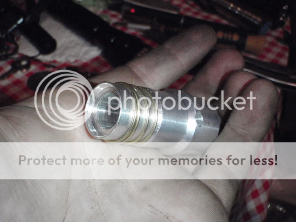

Took a few attempts to get something I liked but this is what I came up with:
The first attempt was supposed to go under the glass of the flashlight host and fit exactly like a p60 drop in (waterproof FTW!!!) but The wire I have ordered from flaminpyro hasn't showed yet and the wire I do have was going to break the leads of the diode off... Need more room
Back to the drawing board.

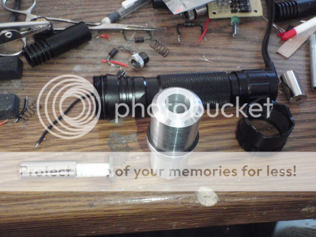

This was the second attempt, remove the glass stick the heatsink out in front
I screwed up and made the relief for the board a little too big plus I got some chatter in a couple of places and made the part sticking out the front a little too narrow.
My third attempt I decided not to bother with the "negative terminal spring" and just made it to fit perfectly just as the threads bottom out. I also made the front part a bit longer because the 2nd one looked a bit stubby :crackup:
