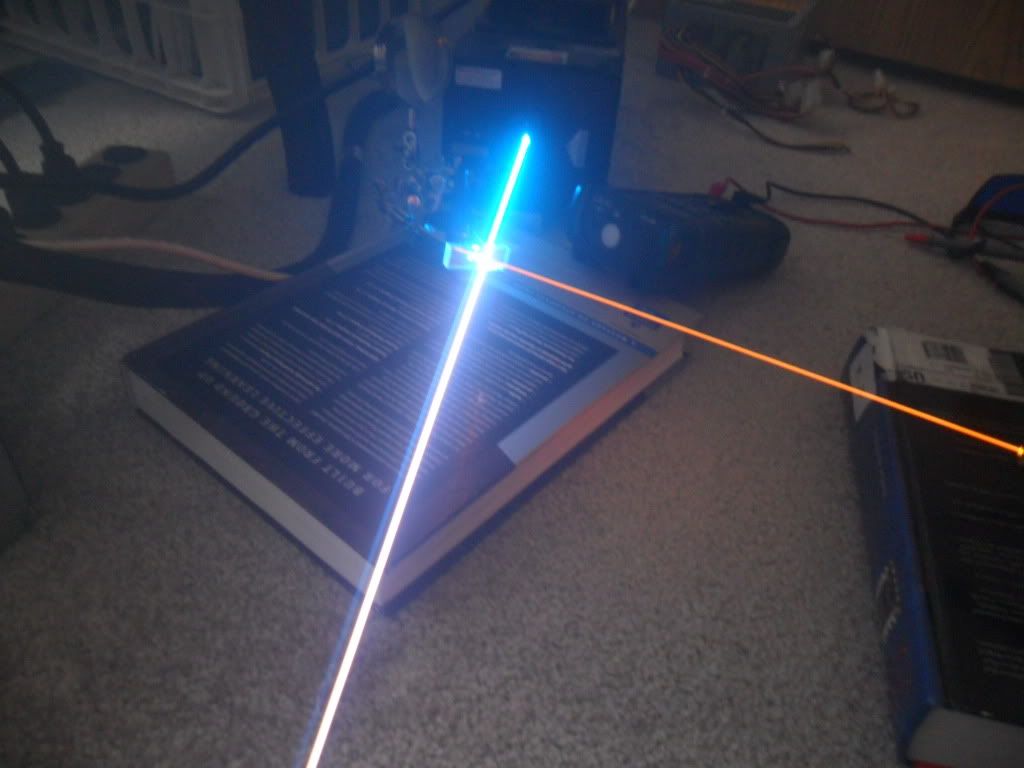

It's been done before, but not recently and not by an LPF member (to my knowledge).
I used my single-line ion laser because it was the only blue that has similar beam characteristics to my yellow. My 473 would have worked, but it's tied up in my projector. The yellow was a 1mW 589nm CNI pen doing ~5mW. The ghost blue is due to internal reflection at the dichro.
I find the best Y-B ratio is 1:4.
enjoy :beer:
See? 2 wavelengths only - no trickery :na:

Way to cool.:gj:
Those Pictures are Awesome.:)
Iam working on a little Red and Blu-ray build but man does white look awesome. Aligning is very time consuming.:)

A white laser beam is always welcome, I didn't know two colors could be enough to make white!
