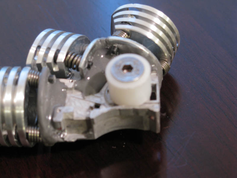

This laser kit allows you to mix your Red, Green and Blu-Ray (Violet) lasers to produce any color you like. Even white!
There are a few types of builds out there that are using this kit. 7 Color Hand Helds, Projector lasers, but the the best fit has to be the awesome driver FireMyLaser is building specifically for this kit: http://laserpointerforums.com/f64/fs-full-colour-driver-extension-white-fusion-kit-44052.html#post584403

The Kit comes pre assembled with a stand-off post on the bottom for mounting the kit in your enclosure. I recommend mounting the kit to the lid of your enclosure so when it is open you have platform to work from. If you don’t want to do that you can finding a hard piece of thin cardboard or plastic to temporarily mount the kit too.
Having your drivers set to a low safe output to start with is also a good idea. No reason to kill your eyes when doing the alignment steps.

2 Adjustable heat sinks fit for Red and Blu-Ray
1 Super sized adjustable heat sinks for your green module
1 Cleaned up and ready to go PHR sled
1 Turning mirror
2 Allen Wrenches
Sled mounting standoff nut and bolt
