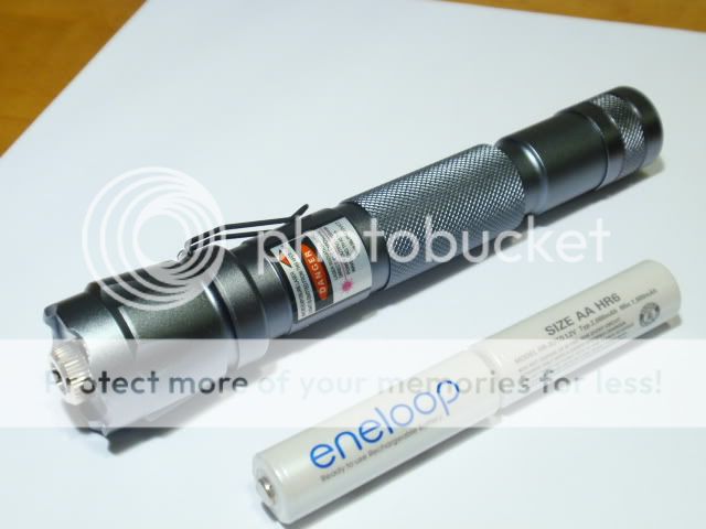

Up for sale is a flexible size and power source Laser and CREE LED flashlight all in one. [smiley=happy.gif]
Driver is FlexDrive with Blu-ray 803T LD in Sure Module with clear Acrylic Lens; Open Can RED LD is available as well for the same price.

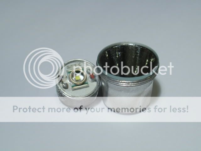

The pocket size takes 1x CR123A 3.0v primary or 3.7v rechargeable, the compact size takes 2x AA 1.2v-1.5v. You also get the CREE premium LED flashlight drop-in with the same size and power configuration as well.
The host is a premium quality Romisen RC-N3 with forward tail cap clicky switch. Host is from
shiningbeam you can get it from DX or KD as well.
Pocket size using 1 x CR123
Compact size using 2x 1.5v AA with AA extension tub

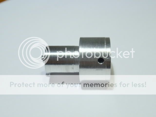

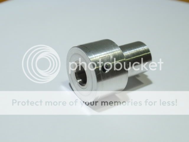

Heatsink from different views

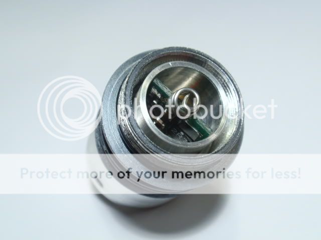

Module and Driver inside heatsink
With this heatsink all you need to do is solder the wires between the LD and Driver and attach a spring to the positive battery side of the driver.
Insert the module with driver from the back and secure the module by a set screw (1.5mm hex key), the backend of the heatsink is bored out to 13mm diameter and 12mm in depth to hold the driver in place.
Heatsink is also available for $30 shipped. ;)
Adonization needs to remove in here in order to conduct electricity.
Complete CREE LED drop-in included. You can turn a Laser to a flashlight or vice versa in 60 seconds.

Complete Flashlight

you got some purty solder joints there mister ;)

Very clean cuts there Mr.Monk :) I see youve been practicing ::)

thanks drew. :)
lol ;D its my third heatsink, first one in this design. ;D Lesson learned, if it cut to well stop and check before it's too late. ;D

Monk, I know any comments from me aren't worth a hell of a lot, seeing as I only had shop for one year in high school, & don't own my own lathe, or other metal working tools 'cept a drill press & grinder, but man, even an untrained eye such as mine, can see that you put a lot of time & effort & design planning into this project. Your reward is a perfect, (near as I can tell) 'sink & diode/PCB holder, all rolled into one. Very, very fine lathe work, that would give Dark_Horse, Jayrob, or any of the other lathe-masters on this Forum, a good run for their money. That is as fine a piece of lathing on a pc. of Aluminum as I've ever seen, NO S**T :eek: :eek: :eek: Keep up the great work ;) IIRC, back in freshman year shop, the lathe was one of my favorite pcs. of machine tools I was able to work on. I also got pretty D**N good at cutting & threading pipe :) I sure wish I could afford a lathe, & RIGID pipe cutter/threader of my own too :( :( Enough of my gabbin', to put this all in a nut-shell, GREAT JOB & KEEP UP THE FINE WORK ;) ;) just rob :cool:
