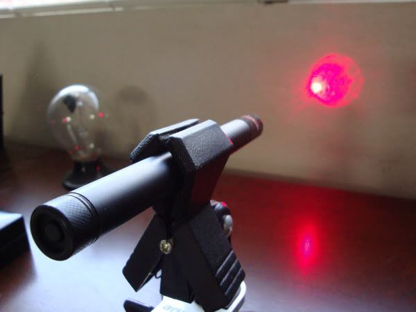

3. SOLD - 300mW 655nm 2xAAA pen. Constant on/off forward tail-cap switch, V5 flex drive, LOC diode, 650nm AR coated glass aspheric lens, & AR coated aperture window.
The focus is fixed to keep it solid and simple. This laser can be run continuously at room temperature for longer than most compact lasers of this power. I recommend 2 minutes on with a brief cool-down to be safe. Comes with foam case. I recommend using a silicone tail-cap to protect the aperture if this laser is stored in a dusty environment or a pocket. Avoid touching the glass aperture window.
Note: LOC and LCC red laser diodes are susceptible to damage from beam reflection. NEVER direct the laser beam back into the aperture of this laser.

However, it seems that its dot isn't well focussed at all, it seems to have lots of "splash". Is that so?
What's its divergence?
Do you ship to europe?
The beam is very tight. Divergence is low at around 0.6mRad with a beam diameter of 4mm at aperture.
The "splash" you see in the pictures is a result of the camera.
I can get a better picture of the beam profile if you'd like.
