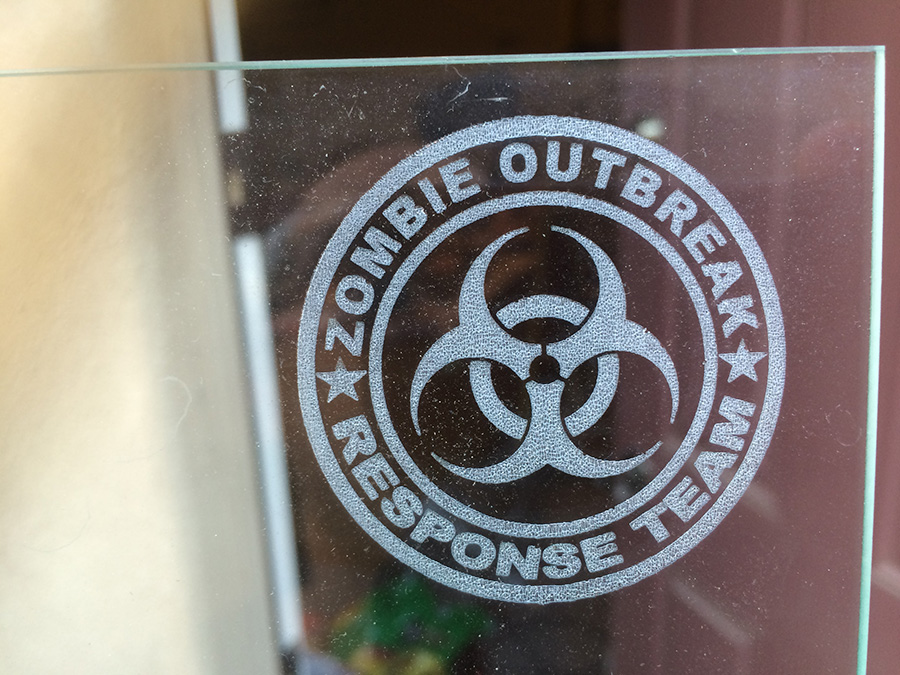

i've had very good success engraving glass with my 60W co2 laser.
It makes sense that the higher the peak pulse power the lower the thermal load on the workpiece would be (as long as pulse width and pulse rate are adjusted accordingly).
Amazing -- I'm impressed ! The old soap scum protected it !!!LOL
We would all like to know more about Max power
and pulse width. +1 or something rep.
Thanks -- HMike
Question: When looking at the edge of the glass, is it green?
i was for sure not running at max power. maybe 30-40% power.
i didn't do anything fancy. it just worked.
