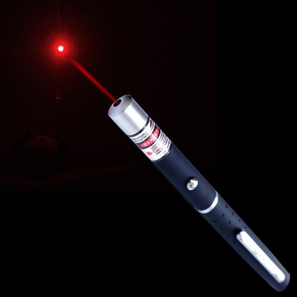

I think Jacob32123 is right, you should look around for a "pen style" laser pointer like the one below.
good luck and welcome :beer:
