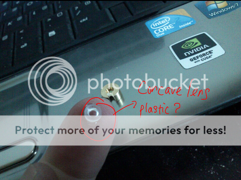

Just wondering if all 532nm crystal was made in such size?
Another thing, as most members knew. It has no IR filter around only the Concave lens being glued on, after the Crystal.
It must be very tough for such tiny crystal to endure high illumination from 808nm diode.
Now I see, that is how they glued the crystal to the diode and then glued the concave lens on it.

Only small pen style pointers have crystals that small. Lab lasers and handhelds that have C-mount diode use larger crystals.

Great info, I would ask Max to see if his lasers are using C-mount diode. :D
By the way, is there any pics to show that - How big is the crystal for a standard handheld such as >100mw?

IME modules like the ones I used to get from O-like use the same size crystals for their 12mm 5mW to 200mW modules. The only difference between them was that the 50mW and up modules used a 9mm diode rather than the 5.6mm pump.
The more expensive CNI units use much larger crystals for their >5mW 532s. Their pens use B-mount diodes and the PGL style lasers use C-mounts.
CNI crystal set approx 1.5mm^2 if I remember correctly. This was from a 50mW pointer:

Thanks bro for showing this pic.
Darn, I felt like cheated by Rayfoss.:yabbem:
But how come Rayfoss gave me the Power Certificate shown 200mw output? Probably a scam.
Can it be justify that this tiny crystal of mine able to give that 200mw output? Or it doesn't about the crystal size ...but the 808nm output???

The size of the crystal alone does not tell you how much power it can produce.
Some of the "200mW" and "150mW" modules I've purchased from O-like and dealextreme were very close to their advertised power. The best one I've tested measured 160-170mW after IR filter (if I remember correctly).
For some people that might be close enough... and for less than $50 it's not a bad deal.
However, I do favor the CNI units with the larger crystals. They tend to be more stable and capable of higher output. The cost is quite a bit more, though.
