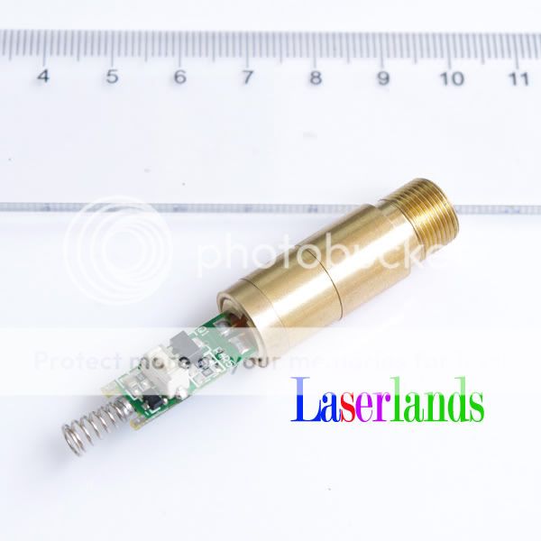

the main question is how can i identify / find on internet for module for that specific laser housing ? and how to take it appart completly (it seems pressfit)

No chance of a repair without a lot of patience and/or expensive equipment.
The part that's broken off is the crystal set responsible for generating 532nm green light.
Without it, you get no green and only infrared.
All that'd be useful now is the driver, and maybe the pump diode too.
Just buy a new one.

thanks a lot for telling me what was broken =)
so basically i buy another green module the same size, swap em, and put the battery back, that would work ?
or i need a new housing and module and all ?
Jun 12, 2010
892
Yes, this laser should take any 12mm diameter module with a removable lens.
i.e. These ones:
See how it comes apart in the middle and has a threaded head? Those are the sort you need.
If you're patient, and have 808nm goggles, you could try aligning the crystal set. But it wouldn't be worth the time.

so, i need a new module set, basically id have to remove the one thats inside,
im not sure wether i need to push, pull or twist to unscrew.... but now seeing the module itself makes me understand more of the inner workin =D
so basically the crystal is inside the module, and i got half the module stuck in the laser and the outer (lens + broken crystal) half removed ?
how can i take the inside apppart withouth breaking the threading or the case ?
thanks a lot =D
