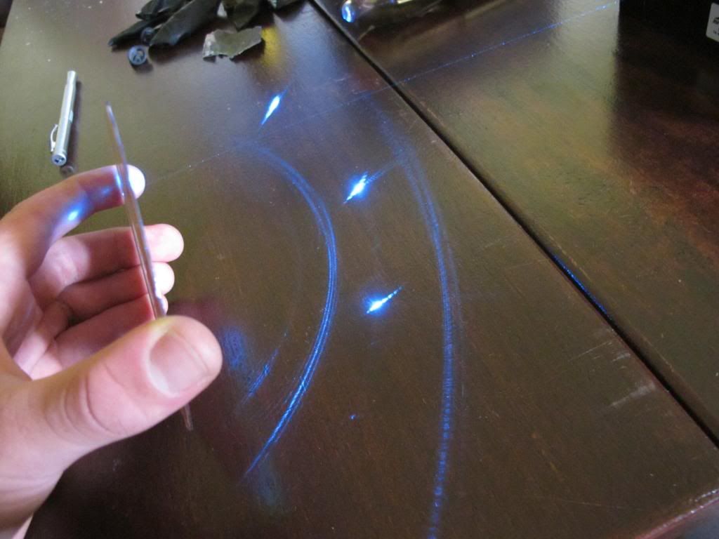

The reflection from a CD.

Escher: I know what you mean, I actually set up a whole laser web in my room using many mirrors but I couldn't get any good photos;( As far as I know the laser is singleline but I do have limited gas laser experience but beam wont split with any of my prisms and it's first owner; Monash university, used it as a monochromatic light source so I guess it's singleline. I wonder what they'd say if they knew it was now in the hands of a fourteen year old...:eg:

that laser is a single line laser - look closely at my avatar and you can see me using the one I recently sold :) it will produce 488nm laser beams only.
Scatter it with a CD (the reflective side that is normally read by the cd players laser) and a multline laser will show up its different wavelengths.
