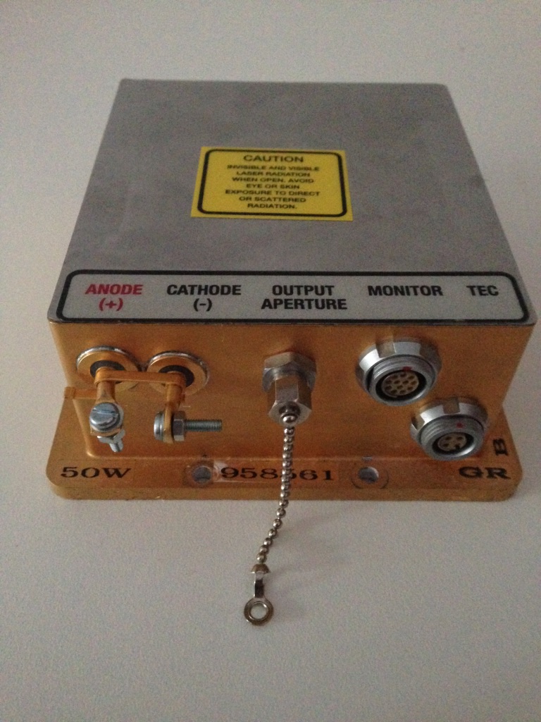

Is there a need to interface with the MONITOR and TEC in order for this to work? Like an enable pin or something similar? I can't find any application notes on this model. Thanks
I've managed to get this laser outputting at threshold by simply just applying current. I didn't need any additional connectors or overrides.
Coherent FAP-I FAP-800 50W 808nm Diode LAB/OEM
