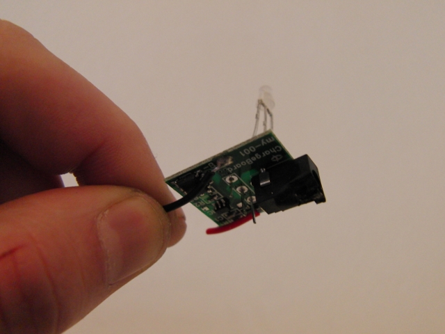

First, open the Tenergy charger. You will see that this charger is very simple:

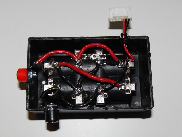

Next, modify it so the batteries are in serial and connect your balancer:
1. Cut the connectors so you only got 1 to 1 connection to the battery poles
2. connect a positive 18650 connector and a positive CR123 connector
3. connect the other negative 18650 connector and the other negative CR123 connector
4. connect the remaining positive and negative 18650 connectors
5. connect the remaining positive and negative CR123 connectors
6. connect point 4 and 5
7. connect balancer to 2 (+), 3 (-) and 6
8. connect power to 2 (+) and 3 (-)
9. You're done..

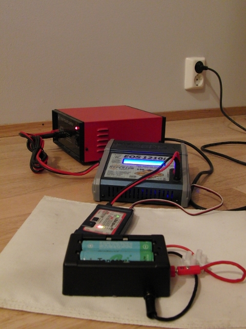

Happy charging:
