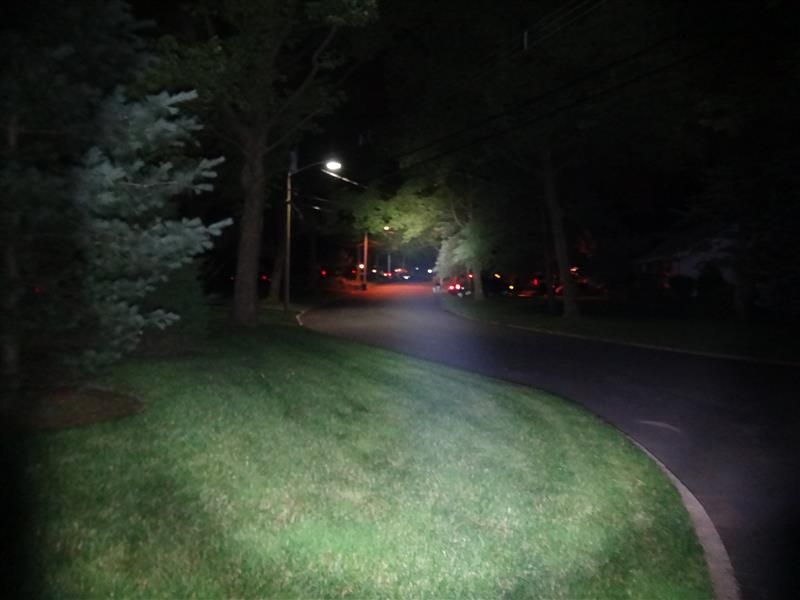

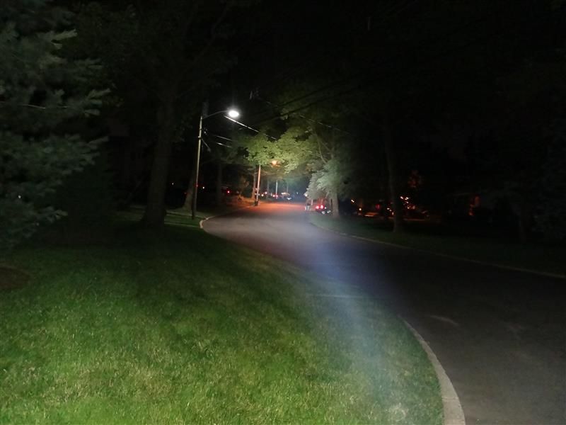

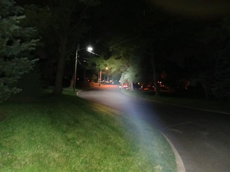

Up first, BEAMSHOTS! :wave:
1 TK75 Turbo
2 FF4 24W
3 FF4 40W
4 FF4 60W

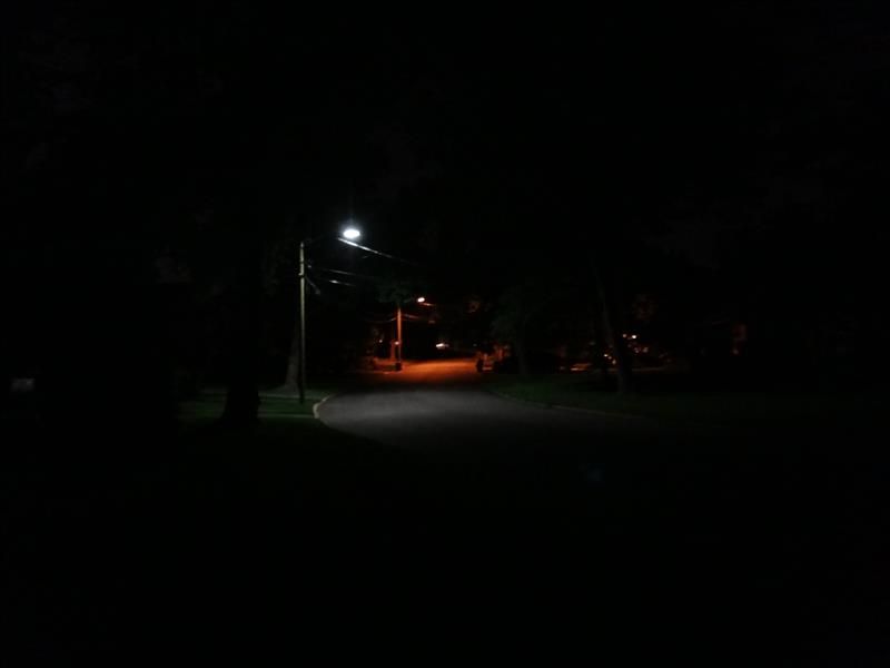

A different location;
Control
6 TK75 Medium
7 TK75 High
8 TK75 Turbo
9 FF4 24W
10 FF4 40W (1)
11 FF4 40W (2)
12 FF4 40W (3)
13 FF4 60W (1)
14 FF4 60W (2)
15 FF4 Just Shining Up
*I took these pictures a little while back, so I don't remember the exact order that they were taken in. For the second location set, pictures 10 through 14, I'm not 100% sure which are at the 40W mode and which are at the turbo 60W mode.
While up close, and at a middle distance, the TK75 holds it's own, at a distance, the FireFox 4 takes a big leap forward, and keeps it. In terms of reach, even on the 24W mode, the FF4 goes further, though with a narrower beam.
While I have other throwers, of all the lights, only the TK75 is in the same league. Other throwers reach equally as far as the TK, or further (see my flashlight beamshots collection thread) but they only light up a very target. Both the TK75 and the FireFox light up not just the target, but the whole area
Due to the fact that the arc on the HID based FF4, is a much smaller light emitting area, the FF4 has a much shallower, and relatively small reflector for it's size and throw.
This also works to produce lots of flood up close. Though you wouldn't want to try reading a receipt in a dark restaurant with this light :shhh::tinfoil:

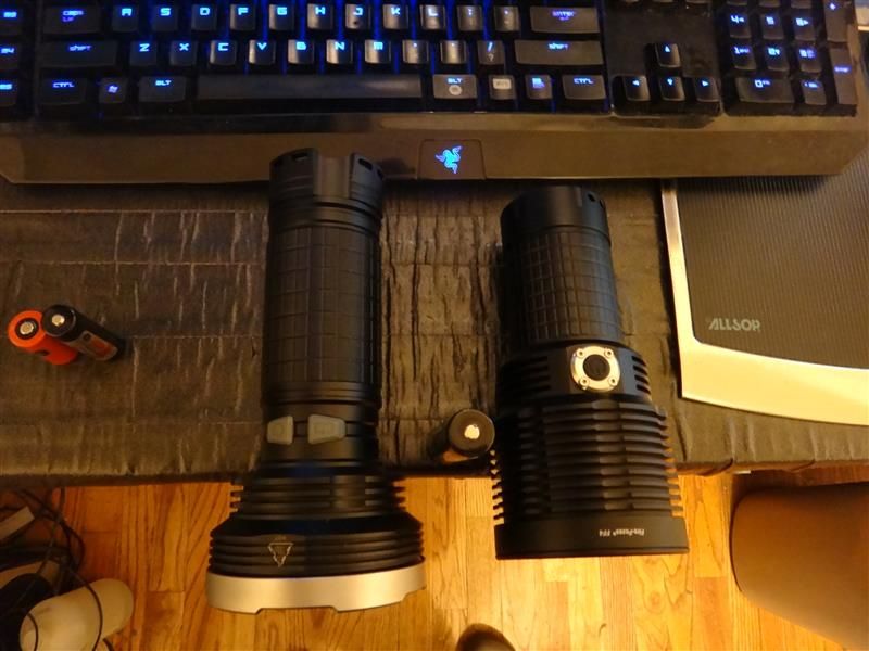

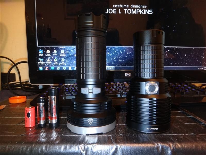

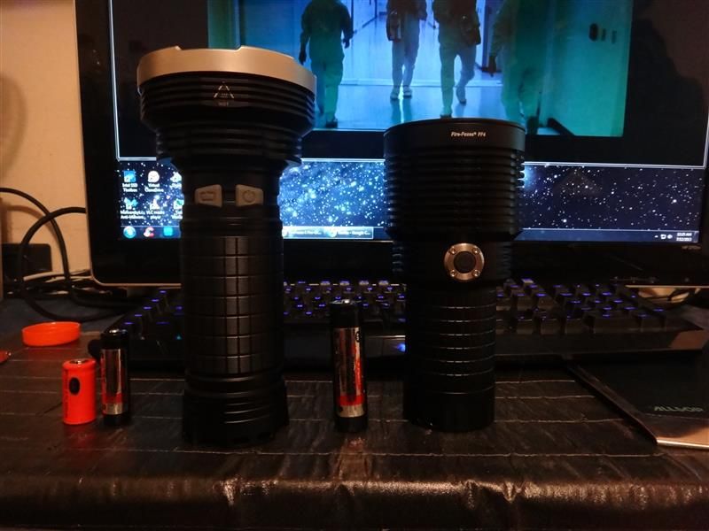

Edit: Some pictures of the two lights side by side;

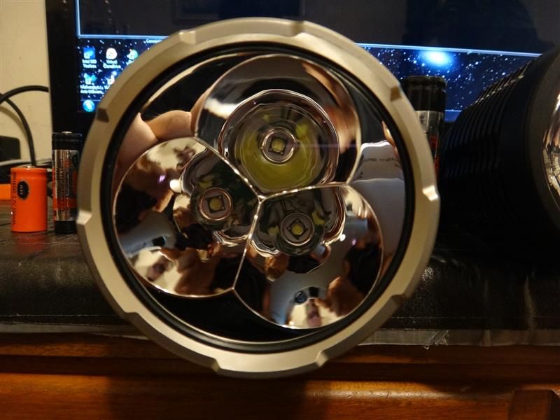

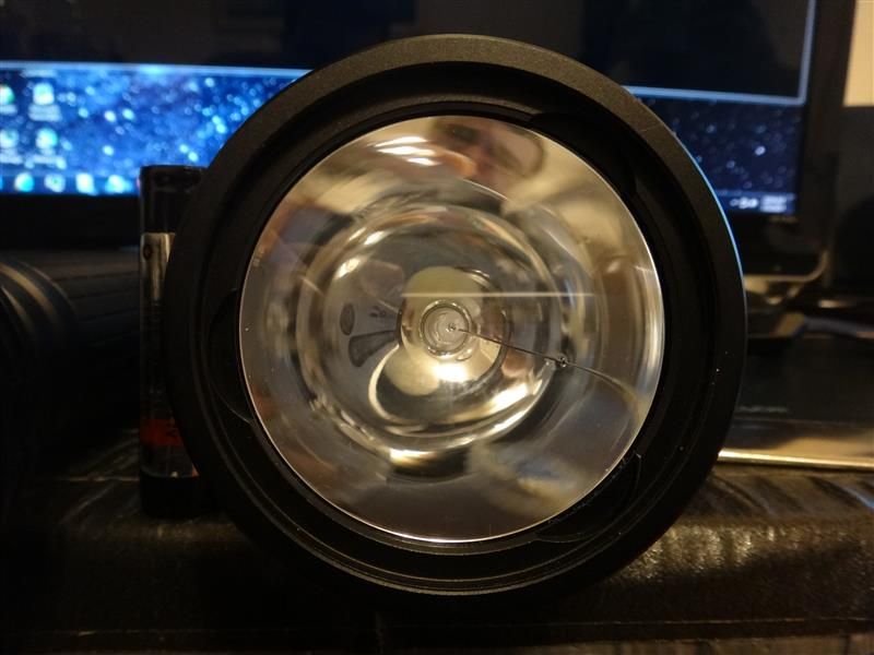

TK75 Reflector;
FF4 Reflector;
