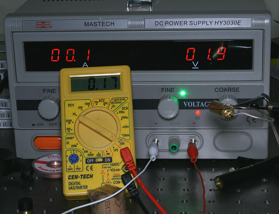

First Mr. Core gets a checkup on a 3V power supply to see how he's doing. A nice 4mW output isn't bad - but Dr. Leadlight thinks he can do better (the crappy $3 yellow multimeter claims a 200mA draw)

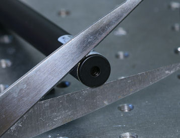

Mr. Core faces some of the crudest tools of the trade to get his aperture cap removed:

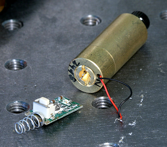

Success! Here we have the Core module - which looks almost identical to the leadlight 110 at this point:

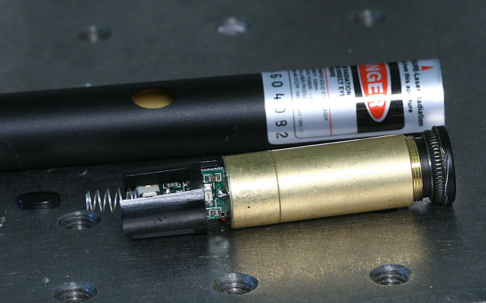

Here is it disassembled a little further:
Mr. Core wait anxiously under Dr. Desoldering Iron. He's quite scared - he knows about all the good lasers that have been lost to Dr. Desoldering Iron.

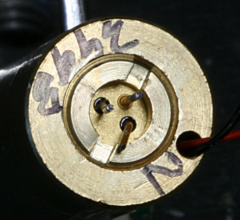

Dr. Desoldering Iron separates Mr. Core's diode from his circuit board:
Mr. Core has 3 legs, but he has nontheless learned to get by using just 1:
And Mr. Core comes out of surgery with Wal-Mart's cheapest speaker wire attached so it can be externally powered:

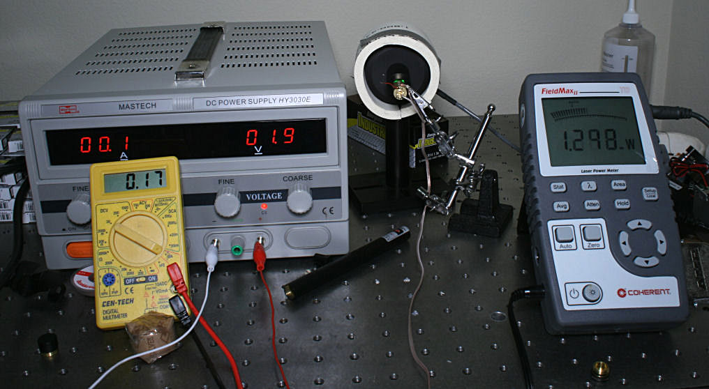

Now for the moment of truth. Has the heat from the soldering iron killed the diode? Have I pulled a psuedo and hooked it up reverse-polarity again? Nope! Its a success! Mr. Core is still working and as green as ever:
However it seems at ~1.9V driving ~170mA, Mr. Core is only managing 1.298mW.
Diagnosis: More Power! (Not you Craig! :P)
Result: At ~2.0V and 270mA we can get an output that peaks upwards of 8.50, but it quickly drops down to 5mW levels.
And now at ~2.1V and 350mA we can peak in the low 9mWs, but it only lasts for a second or two before falling to <3mW levels...
Unfortunately it doesn't look like this module can be pushed any further without dying an untimely death.... but why? It looks like a Leadlight but apparently doesn't walk and talk like a leadlight - this deserves investigation.

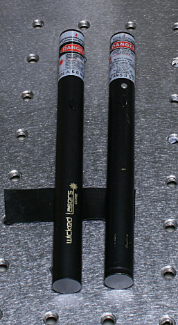

Here we have one of Mr. Core's brothers side by side with a beat up Leadlight 110 black from AtlasNova - the pen clip was accidentally knocked out.
And now we start to see it. Despite amazing similarities to the point that one could just be a later version of the other, we do see some differences between the two (Core on the left, Leadlight 110 on the right):
