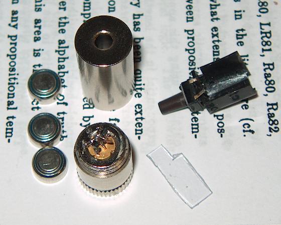

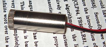

Finally, my DealExtreme Aixiz look-a-likes arrived, so they must be taken apart. ;D
Original (label removed)

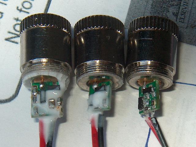

Inside
Strangely enough only one has the infamous yellow led on the driver and two have a smaller driver.

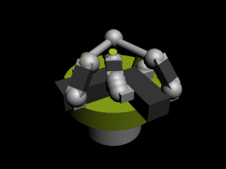

I had an idea that I wanted to put three ag3 batteries inside, but measuring with the calipers, it turned out to be too small. Then I thought why have a driver board at all, when I can have a driver?! :-/ Just a driver, no board ;) :D
I figured out how I would arrange the electronics so the original circuitry is preserved. I did a simulation in 3dsmax with actual part dimensions, and it turned out it can be done with a profile of only 2.5mm.

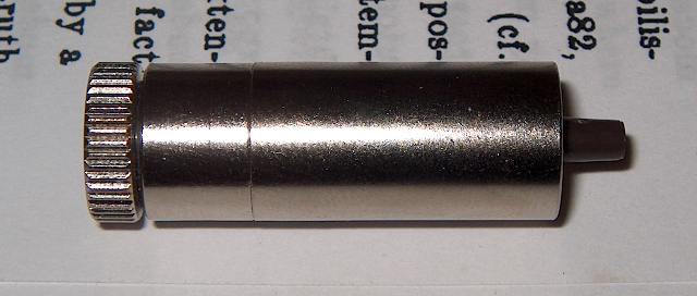

After actually building it had an even lower profile. I had to put a spring on the driver to add 2 mm.
I had to drill the rear hole to 2.8mm to fit my long stem microswitch. I had an old battery compartment from a lighter, but it is open on one side so I added another piece of plastic.
Putting it all together:

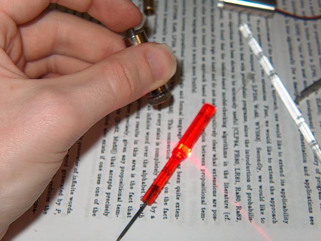

And it works :D (of course it works, because I tested it during soldering, otherwise I wouldn't be assembling it)
[edit] The output power is something ridiculous. I can see the beam im the dark when holding it at my waist pointing it straight forward. Comparing to my tuned up bullet pointers, I guess 10mW output

This has me inspired to look into this again... I hadn't thought of doing the layout in a 3d rendering program though, that's a really good idea. is there any place to download models of standard components, or did you have to make those yourself?
Reminds me of this pathetic little laser pointer that was on top of some pen that was given away at a conference much like the other crap they give out. It was this tiny little laser diode and three button cells. They sure didn't keep the laser bright for long. It had almost the exact same setup as you have there. I ended up taking it apart, but it really never came to much use. It was neat seeing the tiny little spring and lens though.
I made the 3d components myself. Most are not more than a bunch of colored boxes. The LD was a bit trickier and required boolean CSG.
I doubt the conference giveaway lasers had a driver. most cheap lasers operate with just a limiting resistor. Soldering a driver without the PCB will make the laser incredibly expensive. It took me 20 minutes to solder it like this and I'm a pro.
My batteries will keep running for something like 2-4 hour, just like any other AG3 laser with a driver.
your a beast Zom-B!
is that a 635nm laser? I cant imagin the beam being visible if its not.
